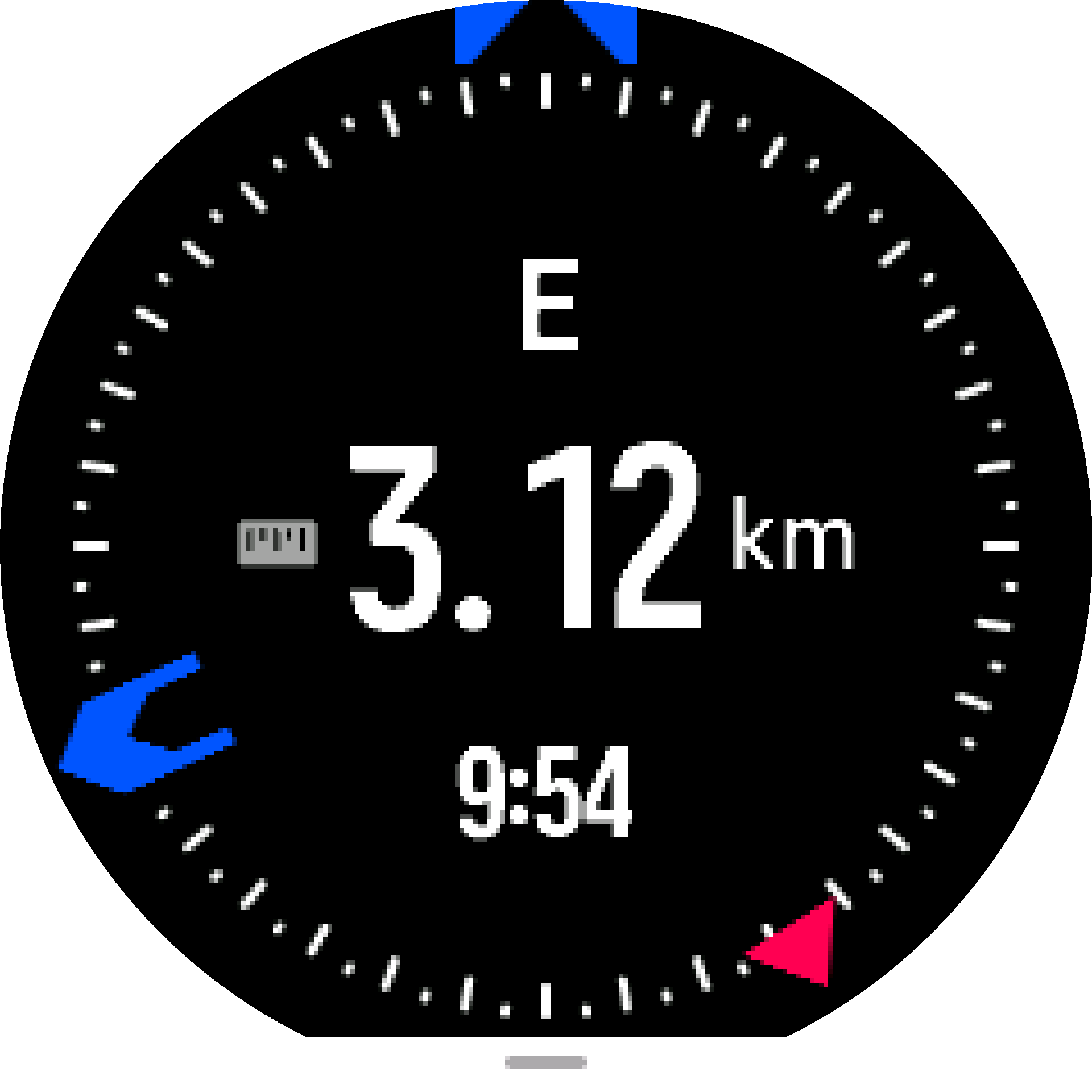

Bearing navigation is a feature that you can use outdoors to follow the target path for a location you see or have found on a map. You can use this feature stand alone as a compass or together with a paper map.
If you set the target distance and altitude while setting the direction, your watch can be used to navigate to that target location.
Bearing Navigation S9PP

  4. Point the blue arrow on the screen towards your target location and press the middle button.
  5. If you do not know the distance and altitude to the location, select No.
  6. Press the middle button to acknowledge the set bearing.
  7. If you know the distance and altitude to the location, select Yes.
  8. Enter the distance and altitude to the location.
  9. Press middle button to acknowledge the set bearing.

  5. Point the blue arrow on the screen towards your target location and press the middle button.
  6. If you do not know the distance and altitude to the location, select No and follow the blue arrow to the location.
  7. If you do know the distance and altitude to the location, select Yes.
  8. Enter the distance and altitude to the location and follow the blue arrow to the location. The display will also show the distance and altitude left to the location.
