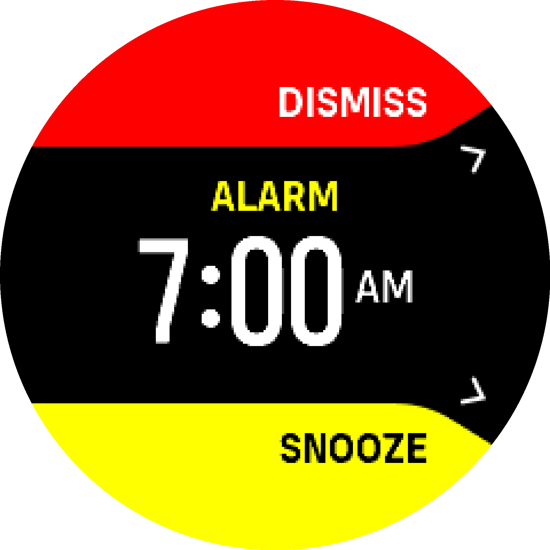

Alarm clock
Your watch has an alarm clock that can sound once or repeat on specific days. Activate the alarm from the settings under Alarm clock.
Besides standard fixed alarms, you will also find an adaptive alarm type based on data for sunrise and sunset. See Sunrise and sunset alarms.
To set a fixed alarm time:
- From the watch face, press the lower button and open Control panel from the list of widgets.
- Select Alarm clock.
- Select New alarm.
First select how often you want the alarm to sound. The options are:
Once: alarm sounds once in the next 24 hours at the set time
Weekdays: alarm sounds at the same time Monday thru Friday
Daily: alarm sounds at the same time every day of the week
Set the hour and minutes and then exit the settings.
When the alarm sounds, you can dismiss it to end the alarm, or you can select the snooze option. The snooze time is 10 minutes and can be repeated up to 10 times.
If you let the alarm continue to sound, it will automatically snooze after 30 seconds.
