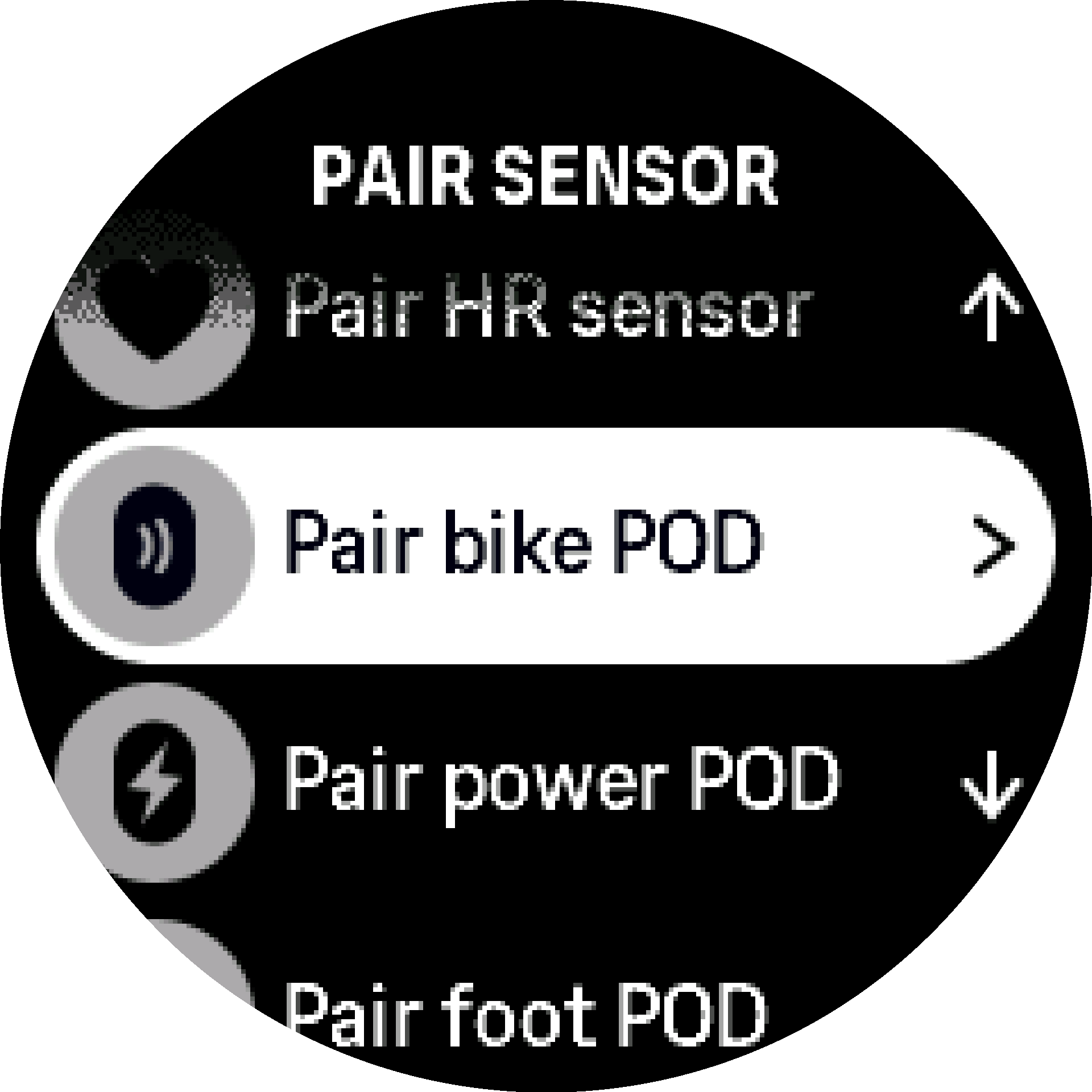

To pair a pod or sensor:
- Go to your watch settings and select Connectivity.
- Select Pair sensor to get the list of sensor types.
- Swipe down to see the whole list and tap on the sensor type you want to pair.
- Follow the instructions in the watch to complete pairing (refer to sensor or pod manual if needed), press the middle button to advance to the next step.
