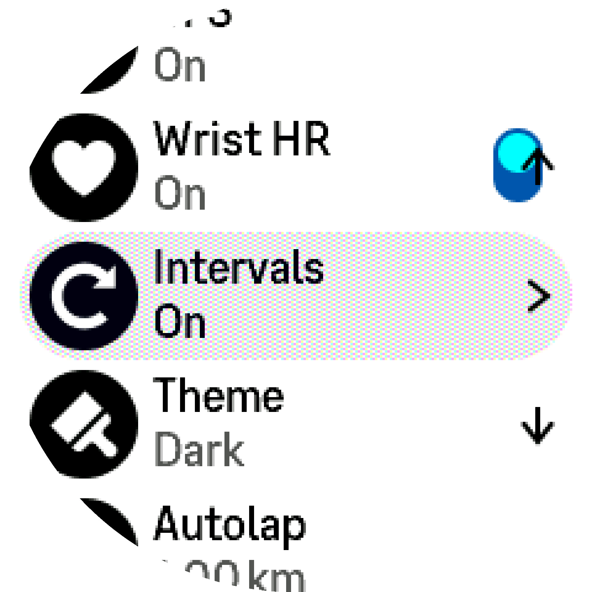

  1. Before you start an exercise recording, swipe up or press the lower button to scroll down to Intervals and tap the setting or press the middle button.
    Interval training settings S9PP
  2. Toggle Intervals on and adjust the settings described above.
