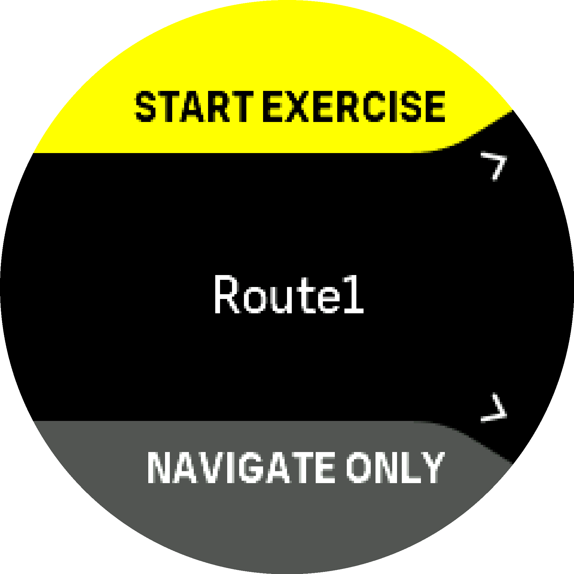

Select the route by pressing the upper button.
Select Start exercise if you want to use the route for exercising or select Navigate only if you only want to navigate the route.
NOTE:If you only navigate the route, nothing will be saved or logged in Suunto app.
If you only navigate the route, press the lower button and select Exit to stop navigating. If you navigate during an exercise, press the lower button and select Breadcrumb to stop navigating without quitting the exercise.
