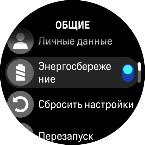

To adjust a setting:
  1. From watch face, keep the crown pressed to open Settings.
  1. Scroll through the settings menu by swiping up/down or turning the crown.
    settings
  2. Select a setting by tapping the setting name or pressing the crown when the setting is highlighted. Go back in the menu by swiping right or pressing the lower button.
  3. For settings with a value range, change the value by swiping up/down or turning the crown.
  4. For settings with just two values, such as on or off, change the value by tapping the setting or by pressing the crown.
    on off setting
