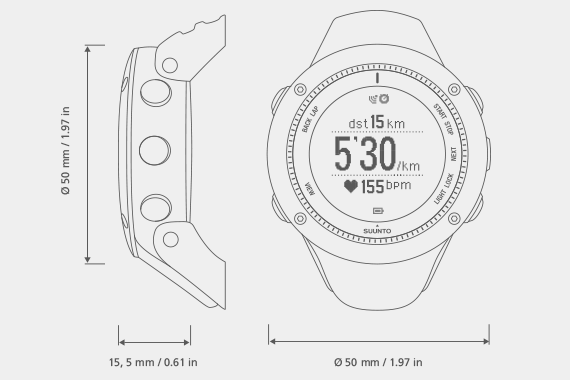

Medidas | 50 x 50 x 15.5 mm / 1.97 x 1.97 x 0.61 " |
Peso | 72 g / 2.54 oz |
